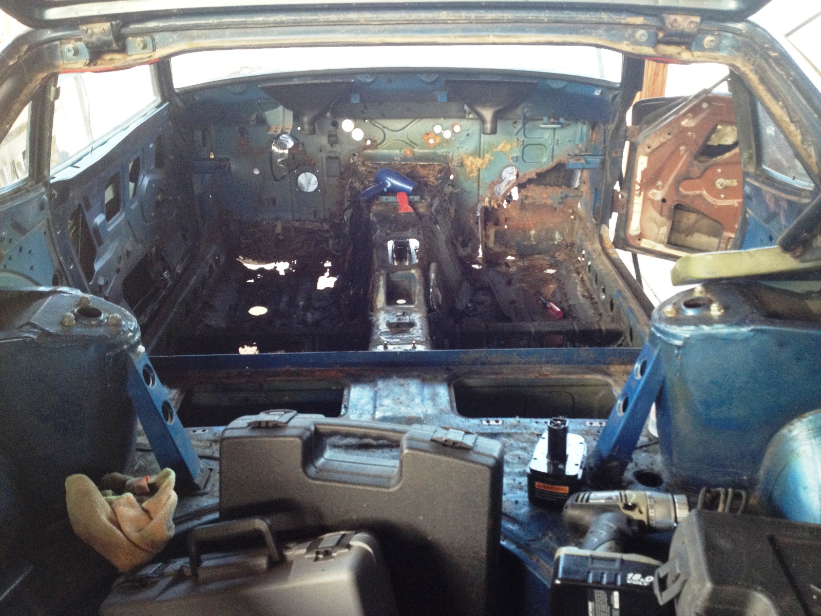

Before and After - Almost Ready for the Show
From July of 2012 when I started pulling the Rust-Z apart to procuring a "parts car" in April of 2013 which became the restored car to today, six days before its first show ... what a journey!
Still have to attach the badges after a final body shop paint polish. There are a few other nits (passenger door lock needs adjusting, rear hatch doesn't reliably stay latched, got to tie-wrap a few wires ...) but for the rest of the week it is pretty much show prep. Detailing, sign board, detailing, polishing wheels, detailing, tire black, detailing and so on.

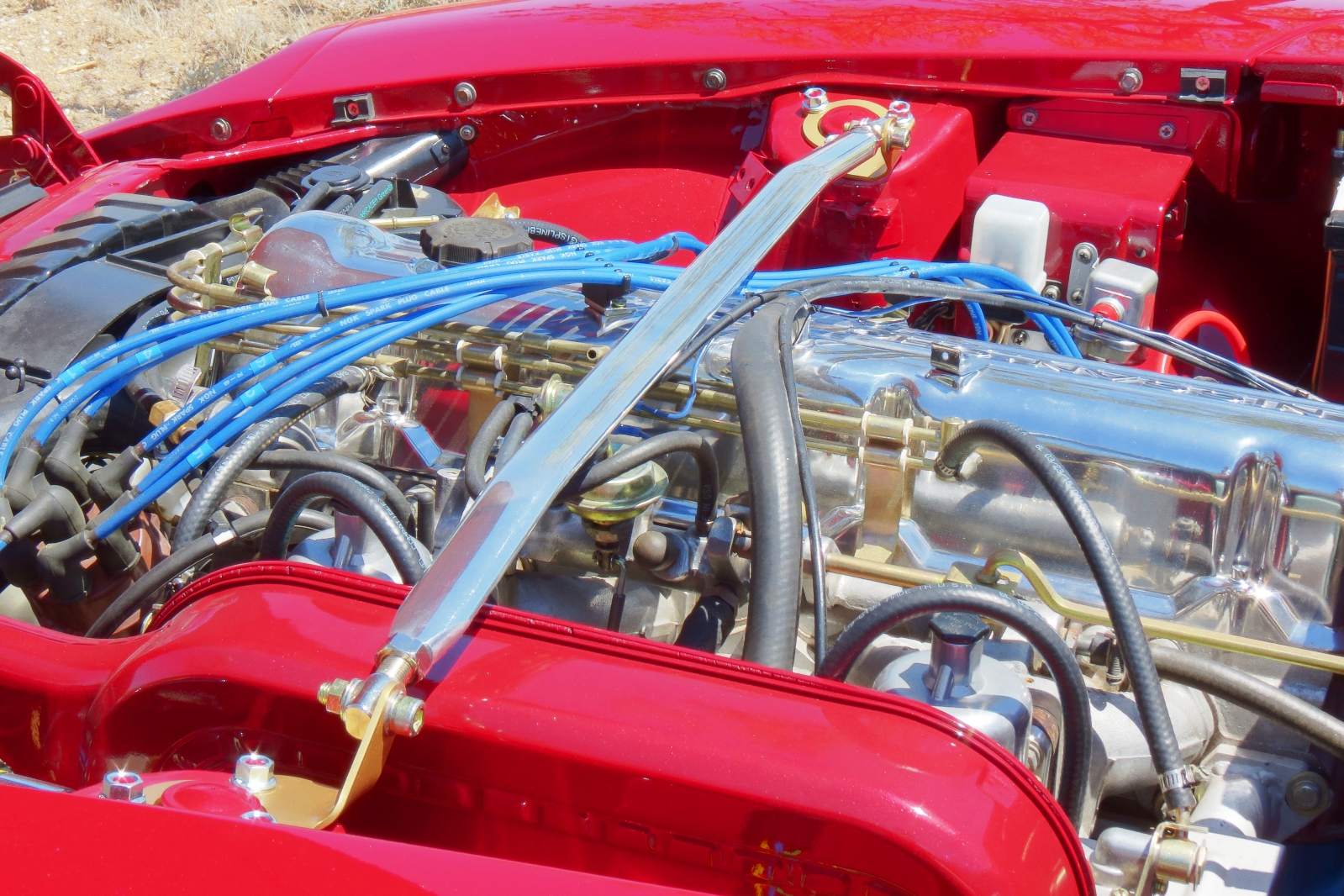

I continue to add bling to the engine bay. Replaced the valve cover with one that's polished. Replaced the old fuel rail with a nicer one that still has its yellow zinc coating and has three pipes instead of two - supposedly more correct for a 260Z.
Adjusted the valves (when I replaced the valve cover) and have been playing with the carbs too. Found out it was running way too rich. Got all that done and the motor is running nice.

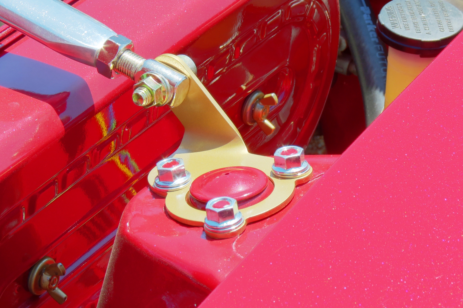

Most recent addition was due to the discovery that "theramz", i.e. Tom, has been selling some nice looking strut braces on eBay. Went whole-hog and got both front and rear. They installed easily and do they ever make an improvement in the cornering.
During the restoration I replaced all the rubber with polyurethane, replaced ball joints, tie rod ends and so on but otherwise the suspension is in a stock configuration. Even with all this, even I could tell (I'm no race driver) the front end would nose in and the back end was a little skittish during hard turns. Once the braces were in, cornering is very well-behaved. It goes where you point it without complaint. Although I don't intend to make it a common occurrence to make hard turns in a show quality car, just knowing I've stiffened up the chassis makes me feel better about the car.

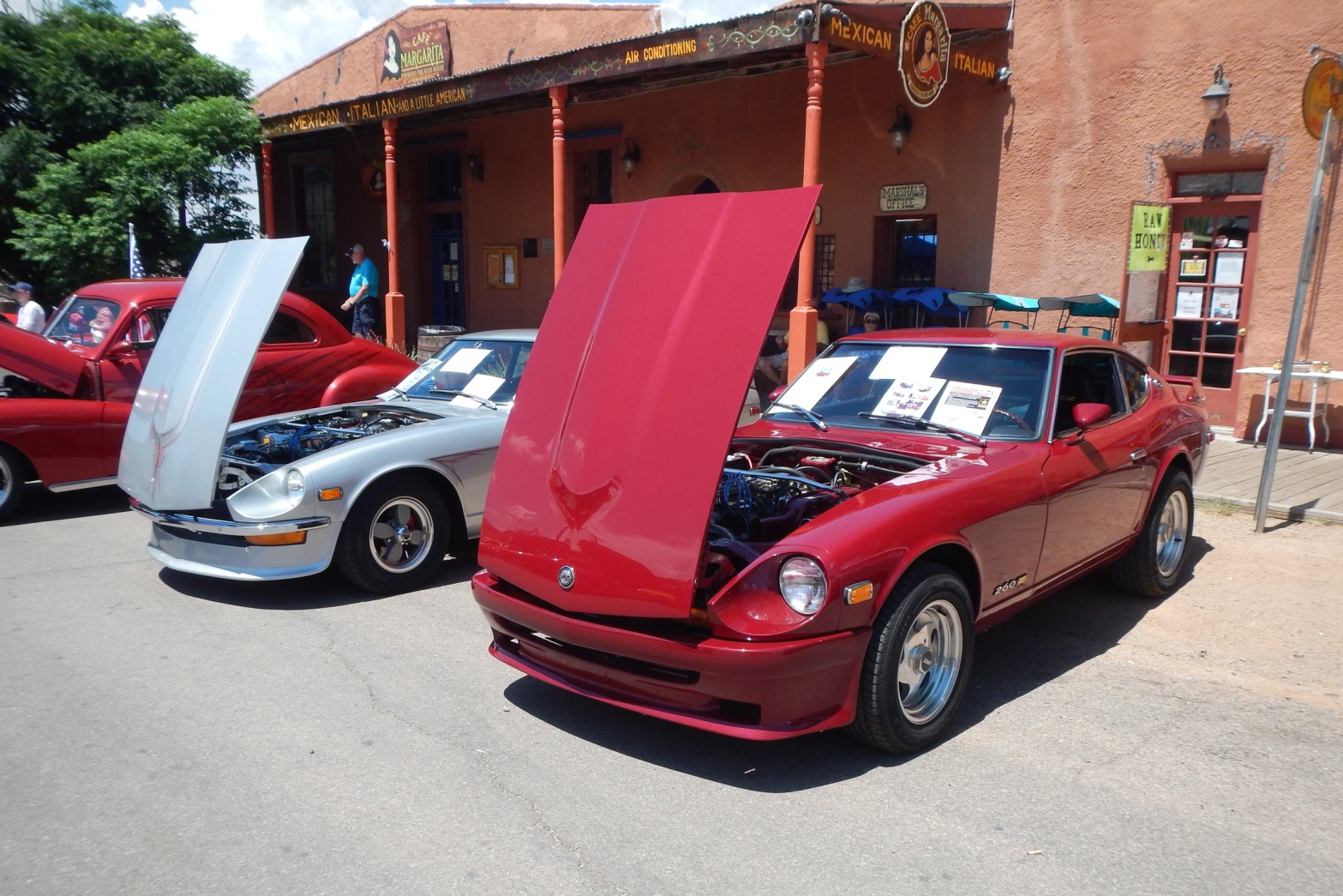

Here are the two Z cars at the show:
The silver 240Z is very nice, I really can't say anything bad other that it is my car's kryptonite. It features lots of chrome in the engine bay, 40 year old paint in good condition with some pin striping, an interior that is "experienced" but in good shape, four wheel disks and so on. No special performance mods.
