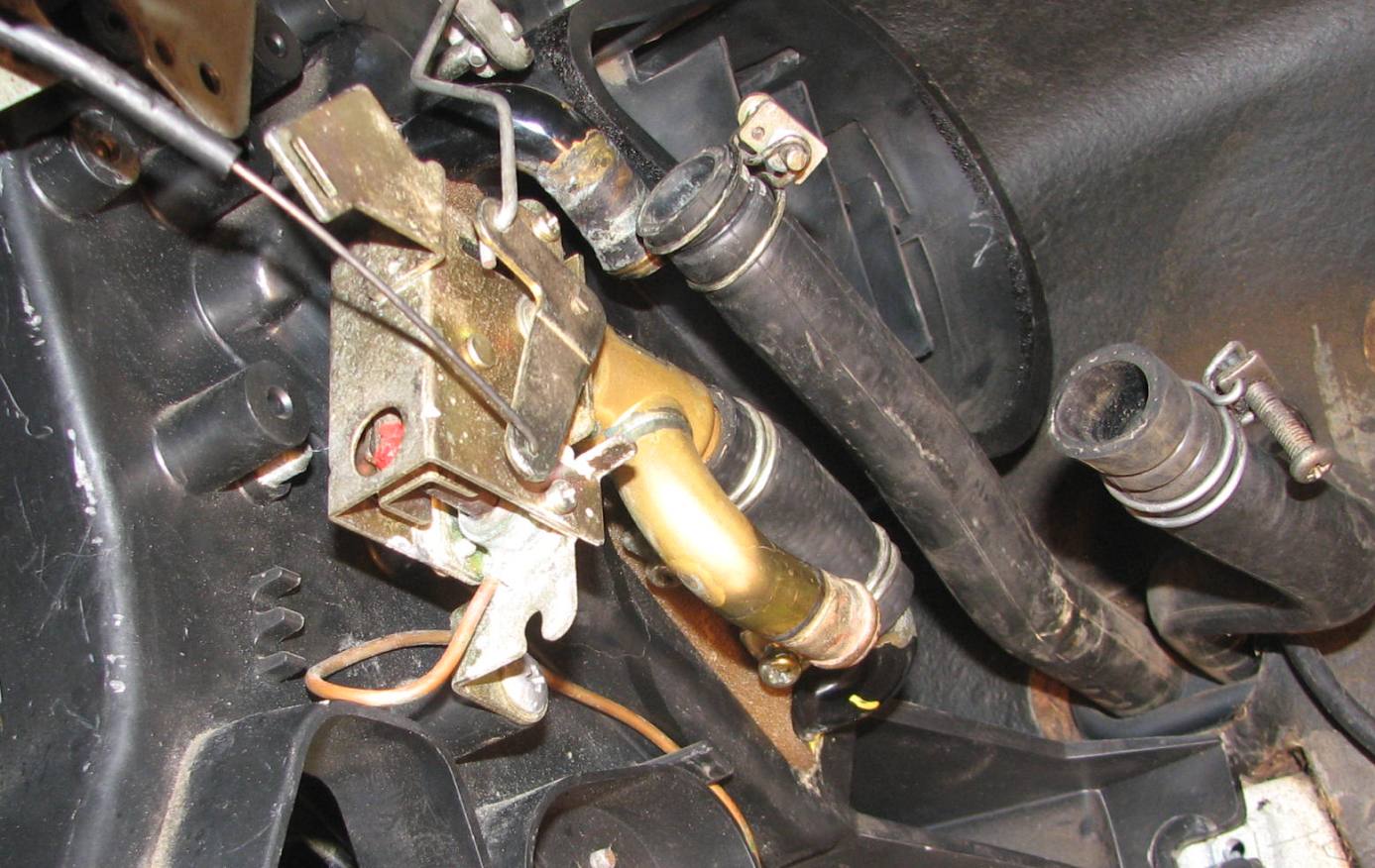

Seems the PO or the PPO removed a heater/ coolant hose, I have picks. From what I have been gathering, perhaps there was a connector there, like a 3 way splitter or some valve ? Unfortunately. short of the Cooling Circuit Chart in the FSM, I have found scant info on exactly what parts are needed to get it back working. Any picks you guys might have of how yours is setup, or comments on my pics would be greatly appreciated as always.

Heater coming
I'm almost completely certain, I need this part Datsun 280ZX Water Pressure Regulator Valve, 1979-83 Nissan 280ZX
From the description, this is the piece I am missing " 280ZX Water Pressure Regulator Valve. New Nissan 280ZX Water Presssure Regulator Valve for the 1979-83 Datsun/Nissan 280ZX. Installs in line with the heater outlet hose on the side of the engine. New 280ZX Water Pressure Regulator Valve."

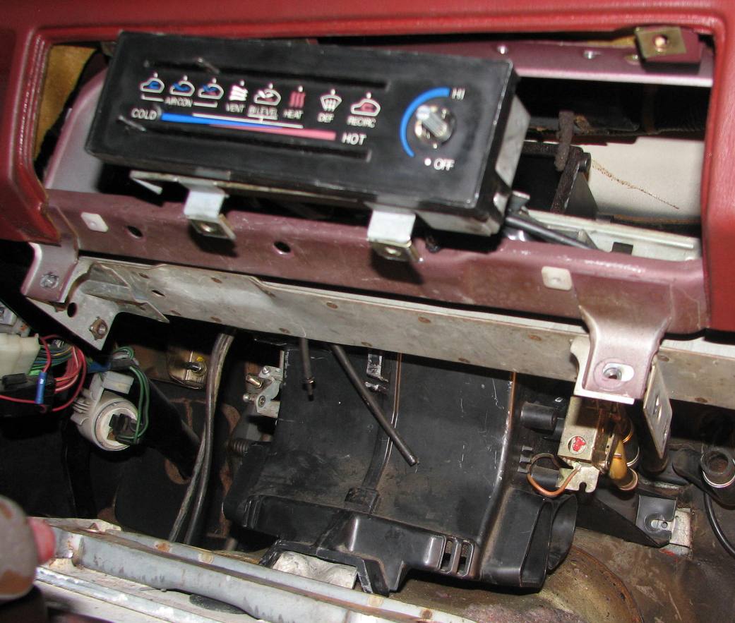

AC & Heater
Removed my heater system this weekend, basically 3 large chunks, the one thing my manual missed that you need to remove the instrument cluster above the heater control to get to a single screw that goes to a small panel that butts up to the top of the heater box, one screw on the end of the 3 gauges lets it slip loose so you can access to the screw. Tried to take as many pics of the complicated parts, like the control, which has all the vacuum lines connected to it, I only took 2 lines off the unit and disconnected all others at the other end of the lines, looks fairly easy getting everything back in order, there are several good diagrams. Replaced the vacuum line that goes from the heater to the vacuum tank, also replaced all the vacuum lines under the hood, and some of the other rubber hoses, mostly the ones the same size as the breather on the valve cover. Got some foam weather stripping to go between the 3 sections, the original foam was badly deteriorating, crumbling away. all the flappers in the heater box have a thin foam pad on them, most could be refurbished, but how ? There might be a kit or just some thin foam sheets and spray adhesive maybe. Once you get the AC unit in and recharged there's no going back, go getting it right now it important. Hopefully it will all go back in today.
Hot Heater !!!
I got my heater all back in and working, took a few pics, but didn't include the blower, it was the 2nd easiest part. I managed to get all the vacuum lines in the correct places, It is pretty strait forward and once I made a color coded diagram, it helped a lot. One trick is getting everything connected on your bench and with a few easy steps you can put it all back in without disconnecting anything, that way I was able to dress the lines out properly, and get it looking half way organized.

Ill describe the pictures, they are labeled by step
Step 1. Get it assembled on your work bench.
Step 2. Set it on the passenger side floor, with the controls seperate from the heater box.
Step 3. Set the controls up on the trans tunnel, lift and tilt the heater box about 1/2 way up.
Step 4. I used the glove box door to prop up the heater box while I placed the controls into its normal location.
Steps 5 & 6 are just getting everything in position.
Step 7 thru 10 show how to angle the control to insert the cable into the valve control, the secure with the clip.
Step 11. Everything bolted down in place. ready for A/C Box.
Step 12. I used 1/2 inch foam tape to seal between each box.
Step 13. A/C Box in.
