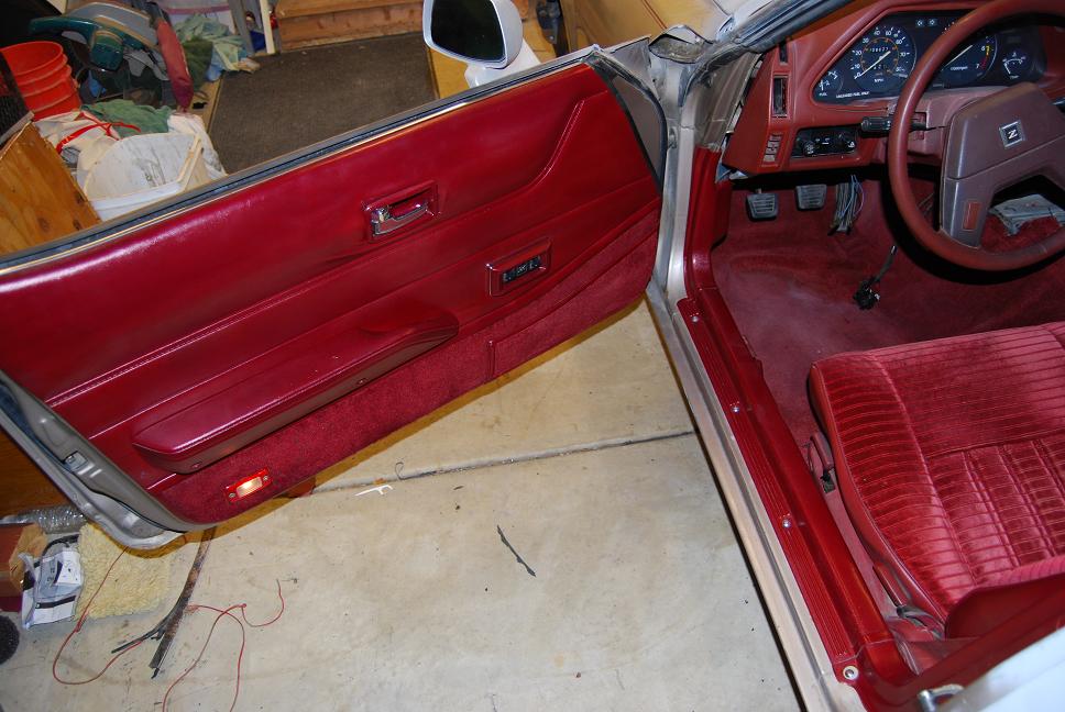

I have painted the door skins and started on some of the trim as well. The color turned out a little more burgundy than I thought it would. What do you guys think of the color. Should I keep on going with it or look for something a little closer to stock?
