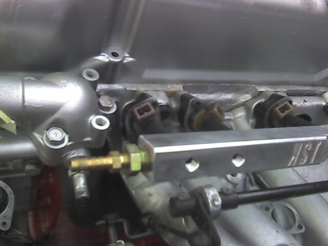

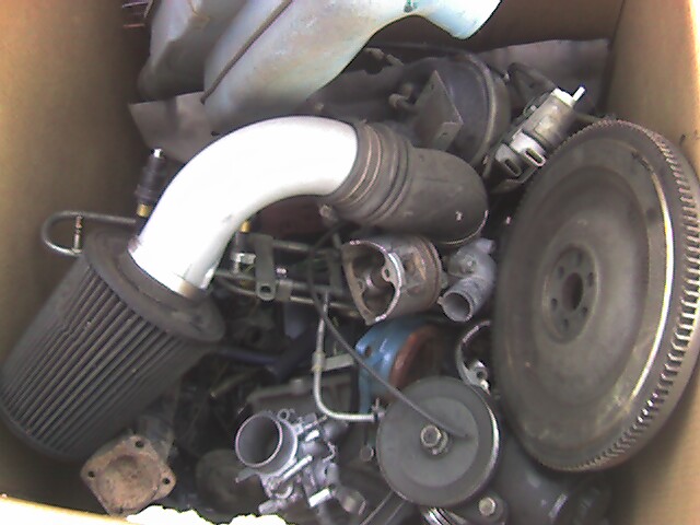

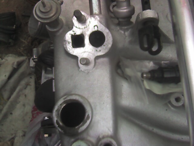

Here is the latest.. I am gonna make some block off plates for the AAC..
and all those unnessary parts

What kind of fuel injectors are you using?
550cc RX7 injectors fit like a charm after you break the plastic tips off
I've got 6 460cc RX7 injectors from some 87 n/a's. I just dremmel'd down the plastic tips till they fit, cuz they won't spray right w/o them.
The needle on mine is still there so it should spray fine.. My friend uses them on his Z with no probs..

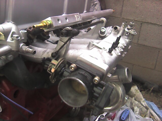

Here is an update.. finally... I have been waiting for some FI holders thats what has been holding me back I have just been busy but I am gonna wipe the dust off of her and do ALOT of work on her tomorrow..

Lookin great! I am sure you have said it before but I am just too lazy to go back look, what turbo is that? The prevous owner of my car recently replaced my turbo so it will do for now but some time in 2006 I plan to get something bigger, I was set on something simple like a t3/t04 but I have realized I want something bigger.

what turbo is that?
A T/4 57 trim .68 A/R and .60 on the compressor side.. Full boost at 3500-3700RPM all the way til the NEW 7k redline..
