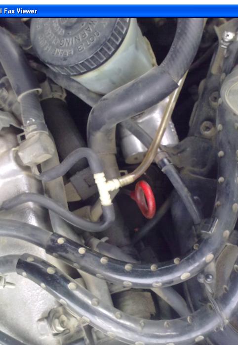

1- What the heck is that in Pic1 ?

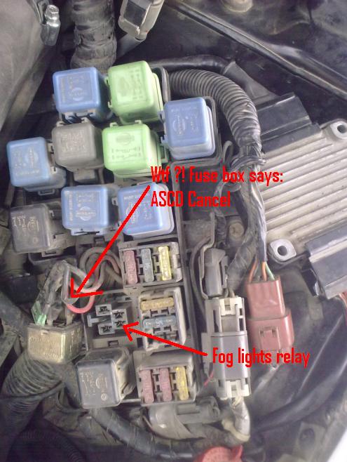

2- As u notice in Pic2 i had deleted the PRVR and that's how i hooked my aftermarket boost gauge.. This may be a noob question thou but oh well.. Can i hook that boost gauge to the boost sensor vacuum line? That would be a lot proper if i could.

1. I don't know.
2. Yes... you can connect a boost gauge to any vacuum source that is connected to the plenum.

As for #1 it looks like someone hacked up the relay connections so they could use a cheap standard relay.

Hmm... I deleted the Cruise control so I would'nt need that freakin relay anyway
The Other relay that is missing is for the fog lights... Previous owner seems to have changed the entire wiring of the fog lights so when i have the low beams on, fog lights are automatically turned on.. i think i may buy a set of fog light ducts and remove the fogs and all their crappy wirings..
